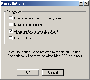

It would be a good idea now to actually reset all games to these defaults, so that you know what settings you're using for each game when you first attempt to run it. Options -> Reset to default... check 'All games to use default options' only. You will now need to restart MAME for this to take effect.
